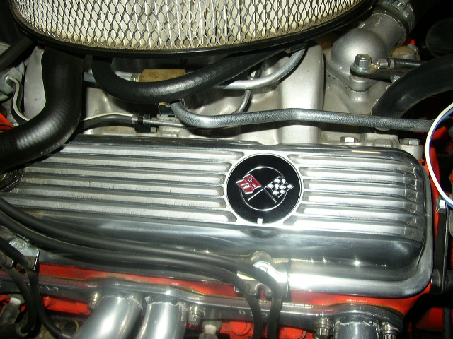

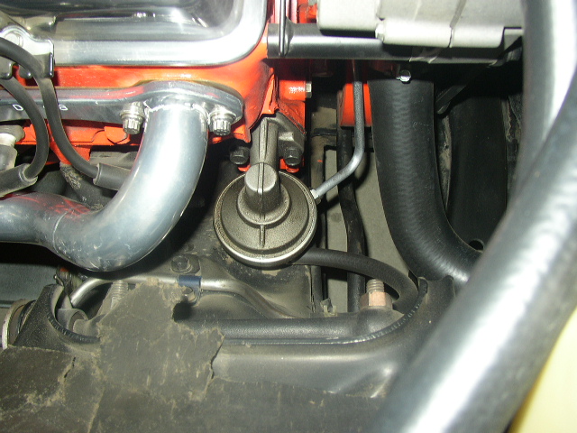

Who is having problems with the current gas with alcohol mixed? My car ran bad for years and left me sitting on the side of the road several times before I figured out what was wrong with it and started using alcohol free gas. I know of several other people who are having problems but don't have access to alcohol free gas. What are the rest of you doing about this? Is there a fuel additive that will take care of it?
