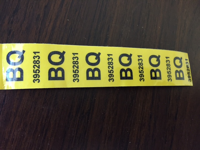

Does anybody know what color the rear spring tags were on a 69 Chevelle, specifically a KK or KQ 4:10 rear end or Big Block Chevelle. A picture would be nice of one.

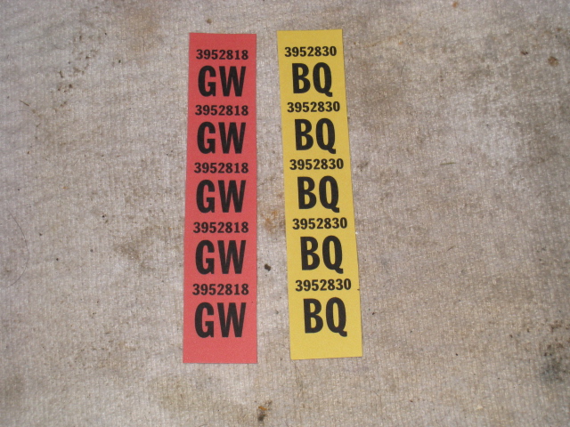

All the rear spring tags for 1969 Chevelles that I have seen are yellow background, black lettering. Here's one I made for one of my cars. Don Lightfoot makes a really nice reproduction of the originals. Just needs a code and part number. Front spring tags were dark red with black letters.
Phil
I have one or two loose tags laying around here somewhere. If I can find I will post a picture.

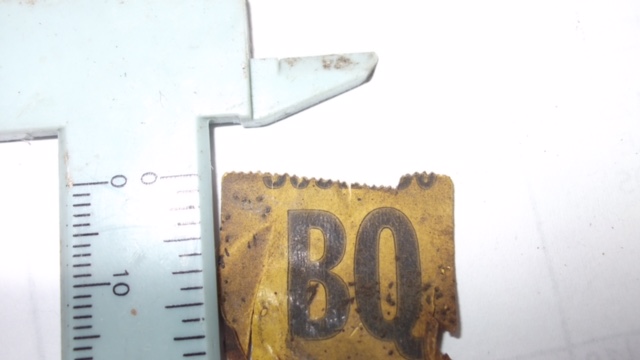

Found a file photo. Here's an original tag from my 69 Malibu. I've found the same code on Super Sports. Don Lightfoot has the correct font for these. The two new ones are his.
Phil
