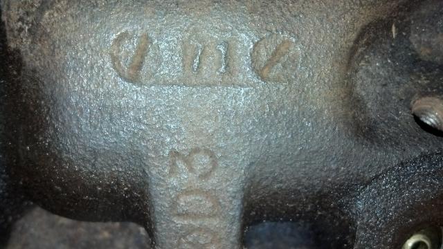

Is there things to look for when determining an original 309 from a reproduction? Thank you, Joe

Yes,but easier to show then tell.Do you have a photo of the one you're looking @?

Which side do you want to see?....Joe
Old 01-21-2018, 11:18 PM
Posts: 21,089
Thanked 3,961 Times in 1,553 Posts
All 4 if possible.Top & bottom too.

Real? I know the cap is wrong...Joe

Doesnt have the date code like mine has?
Bill

There is something there but I'll have to look and see if I can make it out. Should've taken the picture without the bales...Joe
How is the pad with the "US" stamp? I know that even as clean as my original is, I can't make out the US anymore. That's usually the biggest thing being re-stamped/forged I think. I can just barely see it in one of your pics.
-Dave

You can read "US" but it's not real pronounced...Joe
To me, that's a good sign of probable originality that it's not a nice clear stamp.
