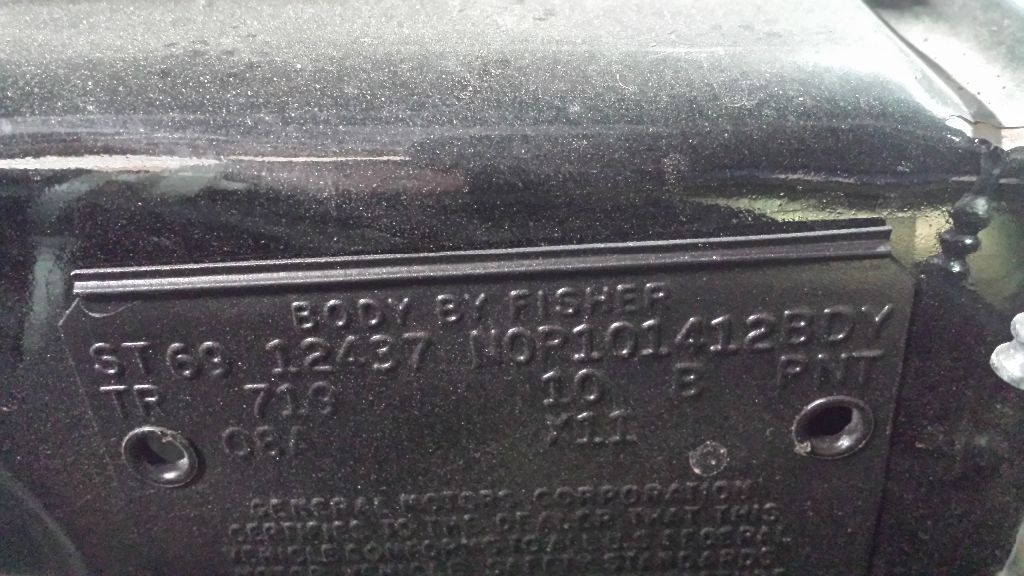

Neat car, trim tag looks real IMO. I can't imagine there are too many black '69 RS/SS cars running around with red comfortweave. Best color combo there is, IMO.

The grille should be Silver, not Black.

Lee, on a SS car?

Black SS or SS/RS get the Silver grille

Not a great tag pic, but I don't think it's original, IMO. Rivets aren't.

Tach & gauges were added. In one picture he shows it with chrome bumper...Joe

That trim tag looks brand new. Not a bit of dum-dum putty either.

For sure on the rivets. If that's a repro tag they have become awfully good! I will have to defer to you on this one....

That tag is a repop and one of the newer ones that's a bit harder to detect.
