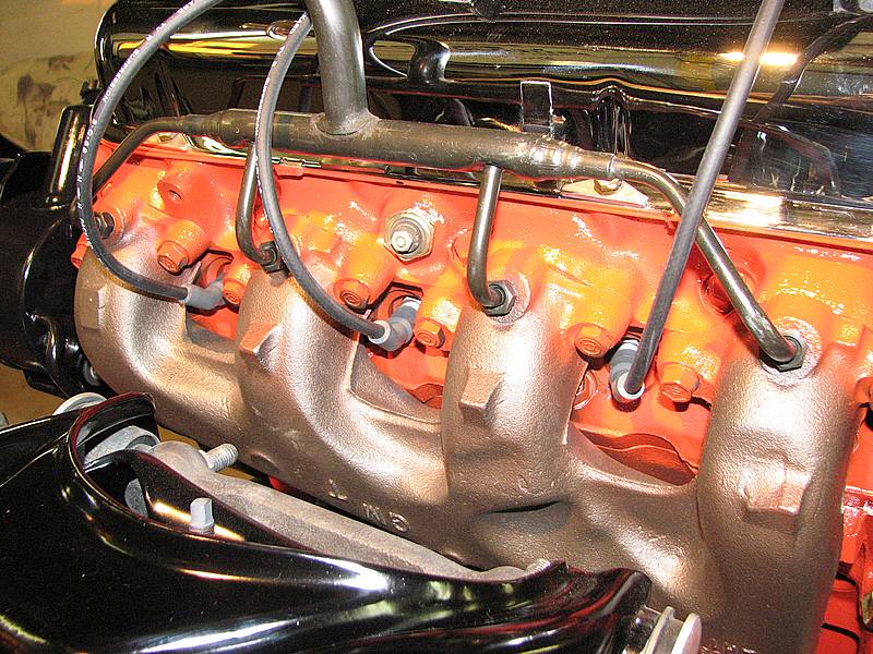

Can't remember for a 1970 chevelle LS6 did the Exhaust manifold bolts to the head use those thick washers?? or no washers.
Thanks in advance.
Ken

Integral washers on the outer four bolts and no washers on the inner four bolts for all big block in 70.

Hi Rick
Thanks very much for the picks, I bought a new set of bolts and none of them have the integral washers all like the inner bolts.
Ken

Some original's with the bolts as Tonawanda built them. To my knowledge no one puts a correct set of bolts together. That's up to you

Good job Guy's thanks for the orig pic's Alot of help.
Ken
