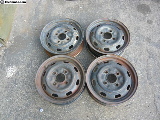

Registered, plated, stickered, insured, waiting for the snow to end.
Just as I was ready to test drive it I found a huge gas leak so I replaced the tank, some lines, filter, etc. etc. to make the fuel system safe.
I also got wheels and hub caps (the caps were a mess so I used Evaporust on them and then Chrome polish... they came out quite well. I still need to restore the wheels.
