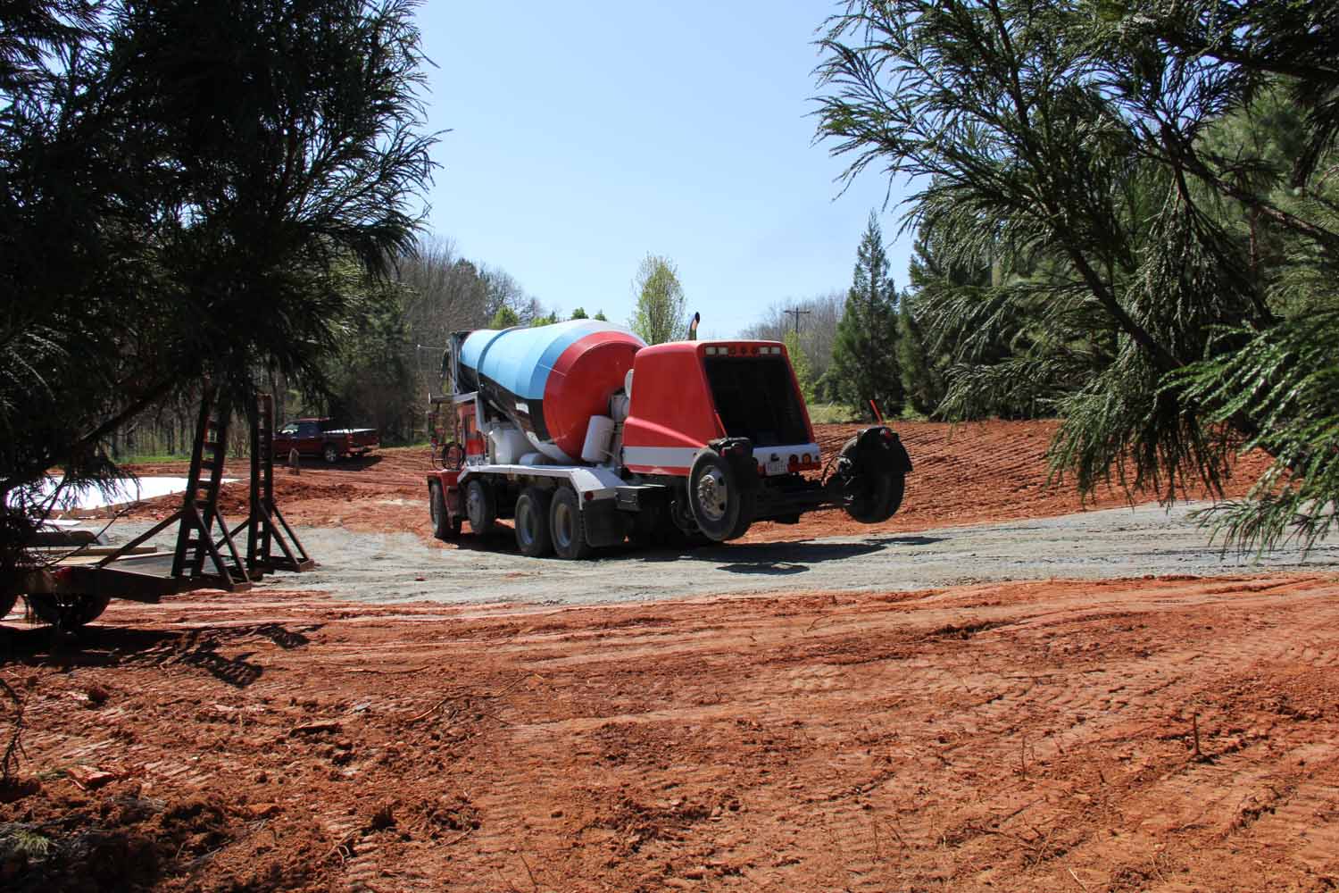

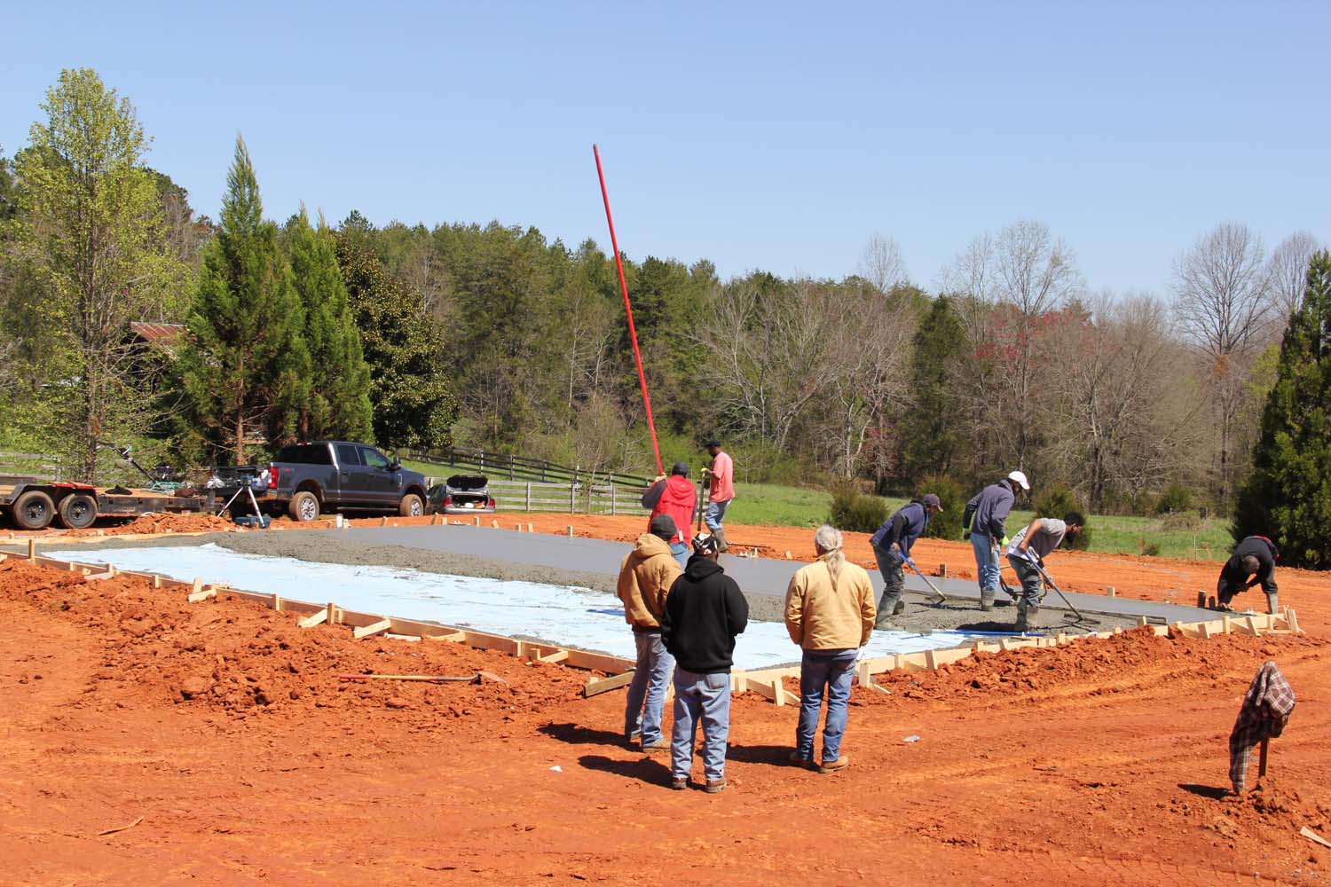

PAD poured today - the building was delivered last week....
Monolithic pad 35 yards 4000# concrete with fiber 51x30 18" footers with Rebar,
1" Extruded polystyrene below grade foam insulation under the pad and footers surround etc, with 6 mil plastic.

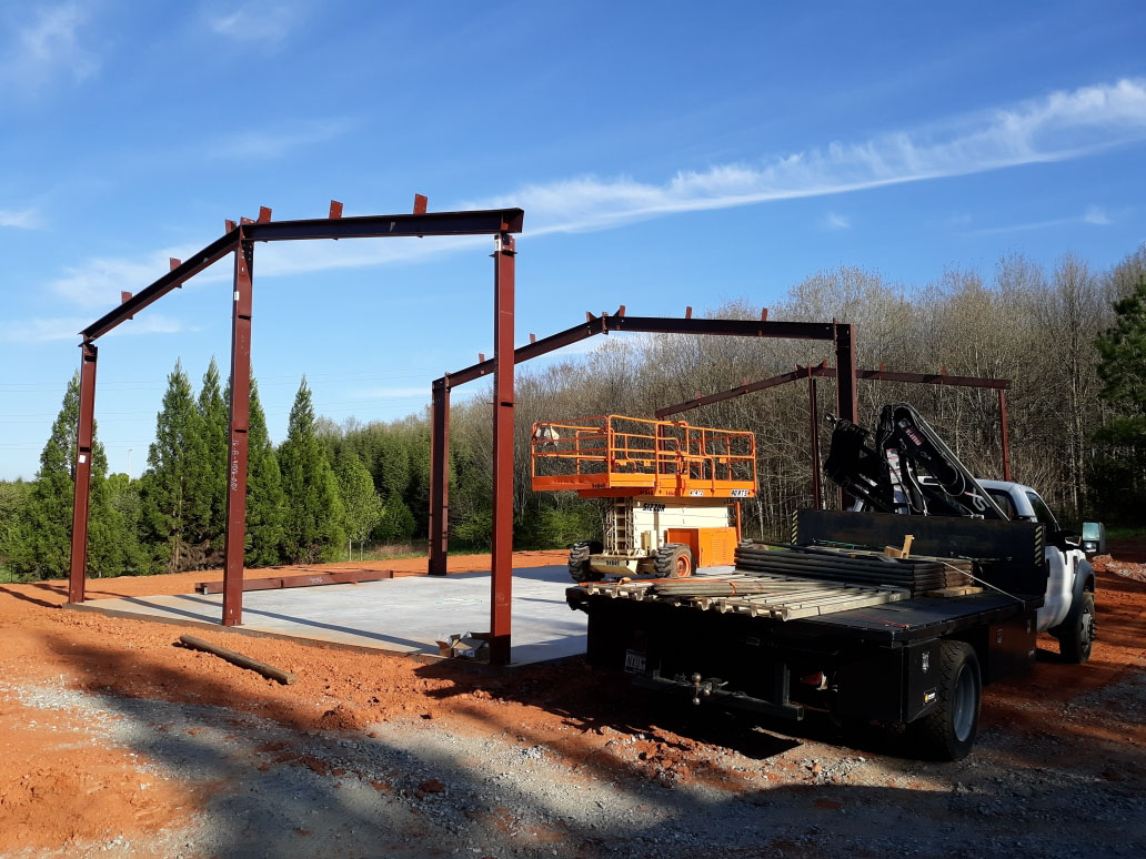

Steel started going up today... WON'T BE LONG!

What up, my concrete brotha from another motha!?!?
I’m right there with ya! Awesome!
