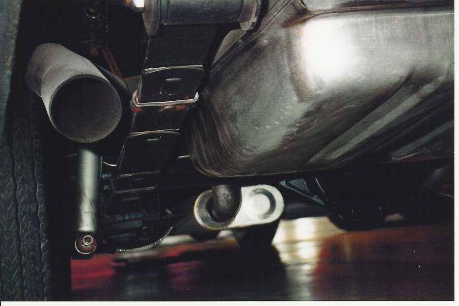

Sorry dude! I suffer from CRS
Here it is.
Marlin

Thanks to all who have replied to this post. It is GREAT to get a little history of this car for my buddy.
Marlin/Camaro Joe, Do these cars use a Hurst? or a Muncie shifter?
Actually my friend bought this car about 1 year ago from another Calgary guy who paid big money for this car.
Yes it still has the original springs with the square lumps? It also still has the flowmaster exhaust, which is going.
On another note did these cars use the crossflow muffler-aka- Camaro type?
Marlin, You mention a B.B Trans crossmember and shifter rods, this car has a small block trans crossmember, which is correct?
Also does any one know the driveshaft length? The shaft appears original, just want to know before i spend time and money detailing it and balancing the shaft.
Thanks in Advance.

rz, It's a Hurst shifter, yes they use the crossflow muffler setup with resonators. If you're going to change back to an M21 you'll need to change the drive shaft yoke. M22s are different ie; bigger output shaft. I kinda like the M22 in mine. Nice whine Schonye

Thanks Schonyenko2,
Would you happen to know if the resonators and muffler are the same as a 70 Z28? Also what size were the front pipes and the tailpipes. Chrome Tips on the pipes like a 70 Z28?
Actually GM did make small output M22,s, this has the big output but we are changing the mainshaft and tailhousing/yoke to make it more correct, but are leaving the M22 Gearset. Would you happen to know the correct driveshaft length eye to eye for the Nova?
Marlin, In your previous post you mentioned the BB crossmember and rods with the SB bracket, is this what these Yenko Nova,s used?
Does any 1 have a picture of the original shifter they could post?
Was the Hurst shifter the same as a non consol 70 Z28 Shifter?
