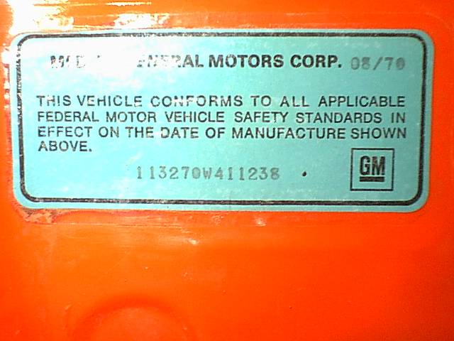

late 70 nova decal.

I don't believe that these foil GM decals were ever installed on 1968 or 1969 camaro's. Jerry MacNeish says intermittently on the 1967 cars. I think people use them because the parts houses sell them. sam

My '67 had the square blue GM foil (Dec 66 Norwood car)before we started restoring it..

My understanding is the foil GM Mark of Exellence sticker was only used in 67. I know this to be true for corvettes and I belive it was the same for all GM's. [img]/ubbthreads/images/graemlins/scholar.gif[/img]

I believe Phil Brewer has the blue GM sticker on the inside door of his 68 ChevyII. I think I have seen that sticker advertised in year one and other suppliers as correct for that model but not for sure. His is shown in the year one ads in the back of A couple of Super Chevy's once A year Nova issues.

If I remember correctly, the 1967 sticker had a different color blue background than the 1968 and they did not use these stickers at all in 1969.

See attatchment, 1969 SS L-78 TH400 Original Paint, built 2nd week Sept. 69 Hope this helps

My 69 Z - late built car (4th week of Oct 1969) has the original door decal installed and the door has
the top and bottom indentations to position the sticker. I believe the 69 camaro assembly manual has
this added and the date this change went into production.
