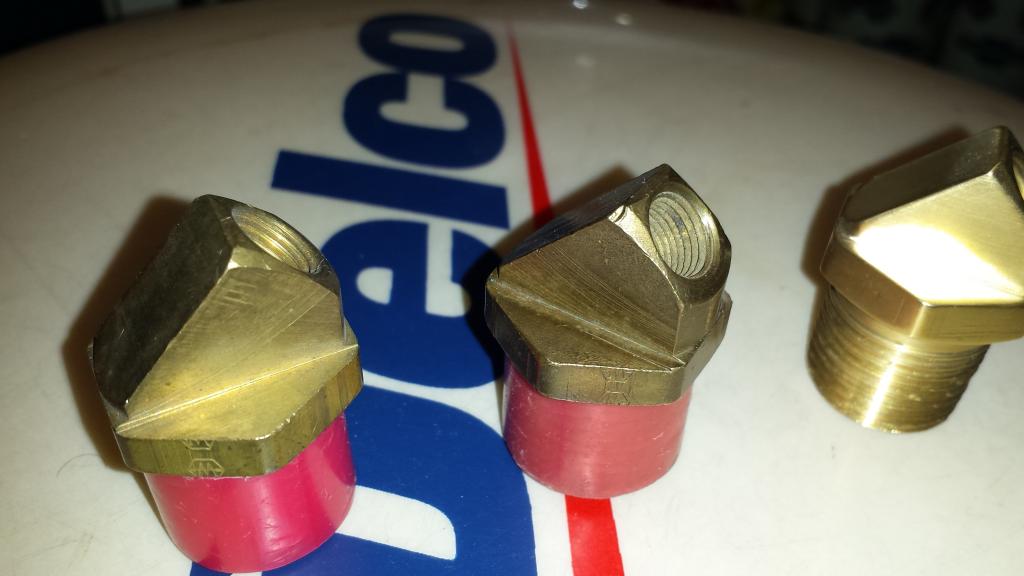

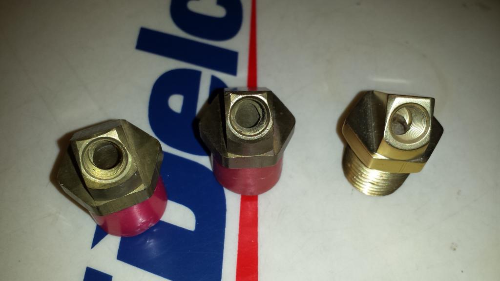

Dave,
Not all of the original fittings have the recess around the outer edge of the hex like the one Rich posted. Here's a few pictures of some NOS fittings and one that I have reworked from a reproduction. I am currently working on making these properly with use of CNC equipment. One of the projects that I am currently doing to make restoring these cars easier.

Nice examples Chris. Thanks. I keep having to remind myself that those are for the 375 hp, not my L34 350 hp 396. I was looking for one of those when my style is actually a little different.
Apparently the 325 &amp; 350 hp big blocks got one that looked like this:
