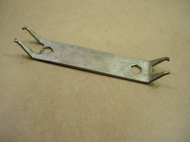

Looking for a source (hopefully local) for removing wiper arms from Chevelles, Novas, Camaros.
Thanks
Here is one offered by "KD" (part # 2039)...
Sam...
Attachments - The Supercar Registry 409809-Anco42-002.jpg 409808-Anco42-00.jpg

I have this one but I bought a different one that works better. I think it was from D&R Classic Camaro. Mark

Sam it looks like this...
Mark

Thanks Mark - not sure how that tool is used. Can you explain?
You stick that pointed end in the back of the wiper arm then lift up the spring to loosen it so you can remove the arm. A screw driver will do the same but since they made a tool I bought it and it works well. Mark
