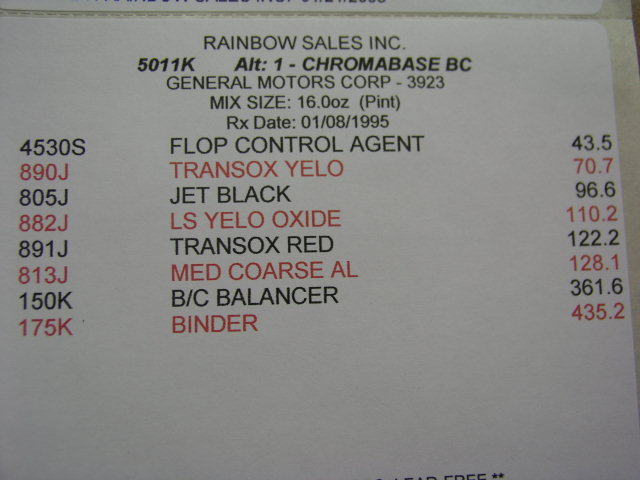

Anyone have the code for Burnished Brown??..my local paint distributor cannot find it and I have no sample to go by..getting ready

Code 61 PPG Car Color List 1969 Burnished Brown Poly

Jed, I need the mixing code..we cannot find it

I have the Burnished Brown paint code as: Lucite 5011L, Rinshed-Mason A-2104, and Ditzler 2081.
Are those the codes you're looking for?

Burnished Brown metallic went by either one of these:
*R-M #A-2104
*Ditzler #2081
*Lucite #5011L
*Fisher Master #3923
*Cowl Tag Code on Special ordered #927-99334
