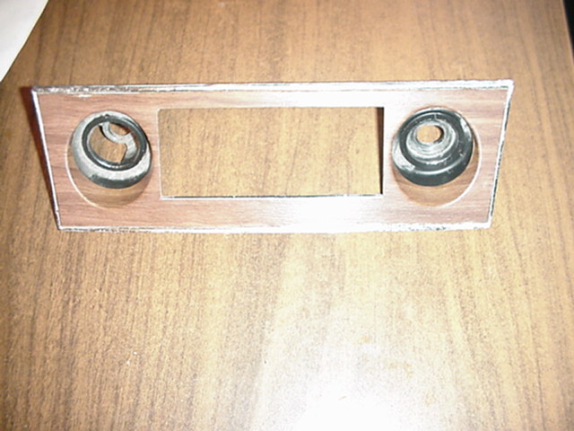

Kim , Woodgrain on 68 Camaro dash bezel typically ran from top to bottom. I do not believe there was a woodgrain radio retainer, only the black. The Firebirds had the lines that ran left to right, (right to left if you're Asian!!) That ran true for the ash tray and radio retainer plate on the 'Birds also. You have a FB part there, sir.

Kim, Whats the number on the back of it? I have a black one that is IDd with 3886998 behind the right hole along with 68...... Just wondering if yours might be 68........
6 dots vs 8 dots

Same part # 8 dots then a 66 and 2 more dots
