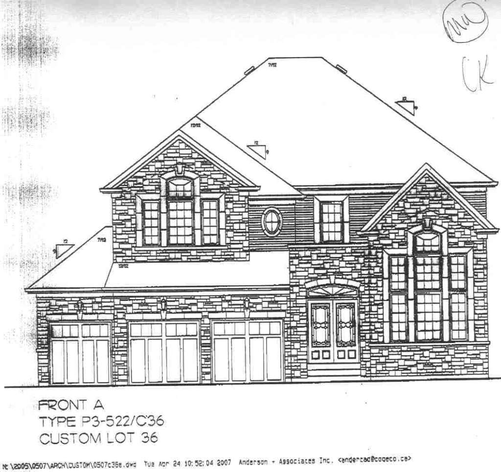

Mark,
The house is going to look nice...3 or 6 car garage ?

Thanks Rich. I'm OK with this move - especially now that there is at least a little money left for a cruiser Hopefully, the timing is good to make the change and I can get back into the rarer stuff at lower prices.
Thanks Bruce...I wish it was a 6 car garage! Prices in the Toronto area are like California. The lot is only 60 x 118 and that is an oversized lot around here! We got one of the last oversized lots in our area. People are buying bungalos for $500K - $750K and leveling them to start from scatch in our city...it's just crazy. Video for sure Bruce
