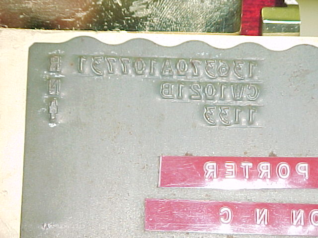

Where's Rick? "Mr70". He knows these cars inside and out!
That buildsheet has me thinking...
Nick...

That Car has a lot of incorrectness.
Nothing major that can't be fixed.
But that Buildsheet is Homemade all the way.

MR70 is correct on the buildsheet. I have 20+ buildsheets from that plant in 1970 and none of them spell out "upper" and "lower". Also the fonts are totally wrong for just about all of the letters, they look to be done with an IBM Selectric typewriter. The Lakewood plant seemed to have never changed its type-set on their buildsheets up through 1976. This guy could pass it off to someone who didn't know what they were looking at.................RatPack...........

That buildsheet looks different to me too....the typing seems to be a bit different than I've seen and light in shade. Also, I noticed the LOWER and UPPER 75 RED. My Atlanta build sheet has them abbreviated as LWR and UPR instead of spelled out.

Oct 5 Week Production, are there really 5 weeks in october or am i reading it wrong
Old 05-19-2005, 08:28 AM
Posts: 21,052
Thanked 3,845 Times in 1,524 Posts
Default Re: What do you guys think of this chevelle?
There are 5 weeks in October.
In 1969,October 1st was a Wednesday,and the 31st was a Friday.
This car actually was built on the Very last day of October 69,but assigned a 1st week of November VIN#,which is likely.
Based on the buildsheet though,I would be suspect of the Protect-O-Plate too,unless he shows a close up of the embossed metal plate portion.
