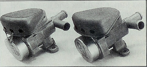

Need input to determine originality of my Smog system. This is 1st of several posts on subcomponents:
Each clamp has a date code of 1/69. Do repros have date codes? Also, is this an original valve in this picture?
Thanks,
Sam
Sam...
Attachments - The Supercar Registry 135907-Scan0014.jpg 135896-68smog8resized.jpg

Sam
Black Fans are later 70's issue.
Whats the date on your Pump?
Look for a small machined area underneath with stamped numbers & letters.
Whittek here in Chicago made the tower hose clamps originally.Do you see their name stamped into them?
Repops are date coding them too.
Show me the other side of your Check Valve.
Smog pulley has correct Number & Suffix,and looks real,but need to see it's otherside outside lip.
Not quite sure,but that could be a ASL Smog system.
