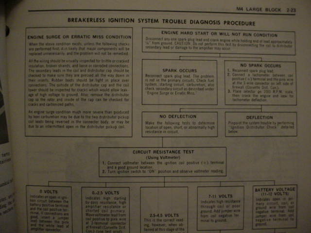

There is a page on diagnosing TI problems in the old Chevrolet Power handbook. I think it was also in some of the old MOTORS manuals. I'll attaching half a page, but it may not be clear enough to read.

I can read it, thanks John.
