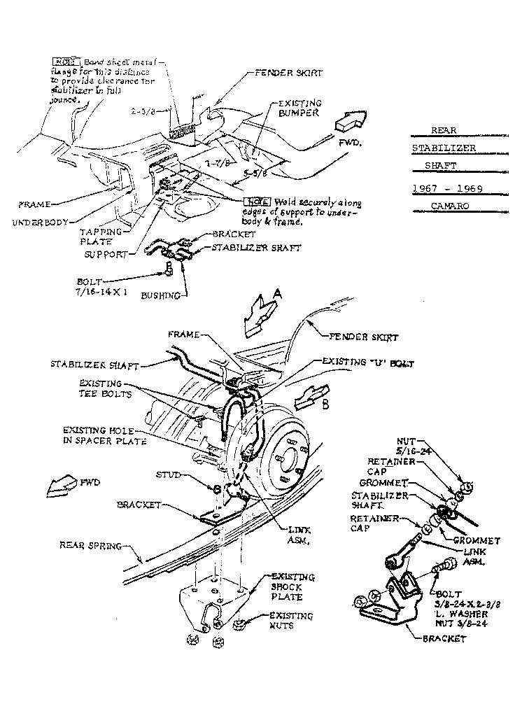

I talked to Wayne Guinn about the rear sway bar. I was wondering if it was worth trying to locate one for my car and he said they don't fit the multi-leaf cars. So they were designed for 67 only and they didn't help very much so they discontinued the effort. Got any pictures of this setup you're talking about Mark?

Well, heres the drawing of the 67-69 rear swaybar attached, and it shows multileaf springs, so it has to be for 68/69's, unless there was some artistic license taken.
Mark C.
