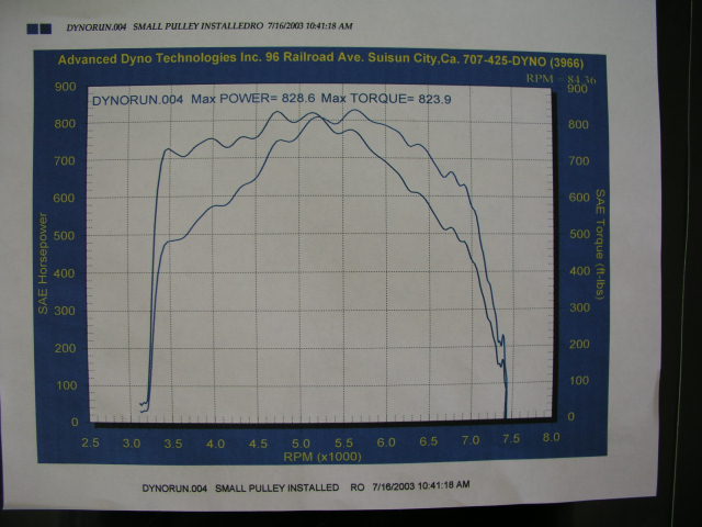

Had the Animal on a Dyno Today. Here is a pull with the lessor boost pulley making about 11 lbs of boost with 91 Octane Gas. The Readings are at the rear Wheels.

I then changed the pulley and Belt to up the boost. It was looking good, making power but needs more Fuel. We never got to really bump it up because the 3" inlet Hose split wide open where the water injection fitting is and dumped all the boost. Now I need to relocate the water nozzle.... WOW this thing is Cookin....

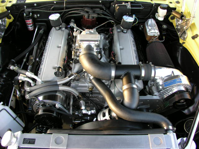

The Engine... 540 Arias with a D1SC Procharger

It's really a nice/clean engine-bay to put out that kind of
right-now surge of HP & Torque--Very Professional--JoeG
