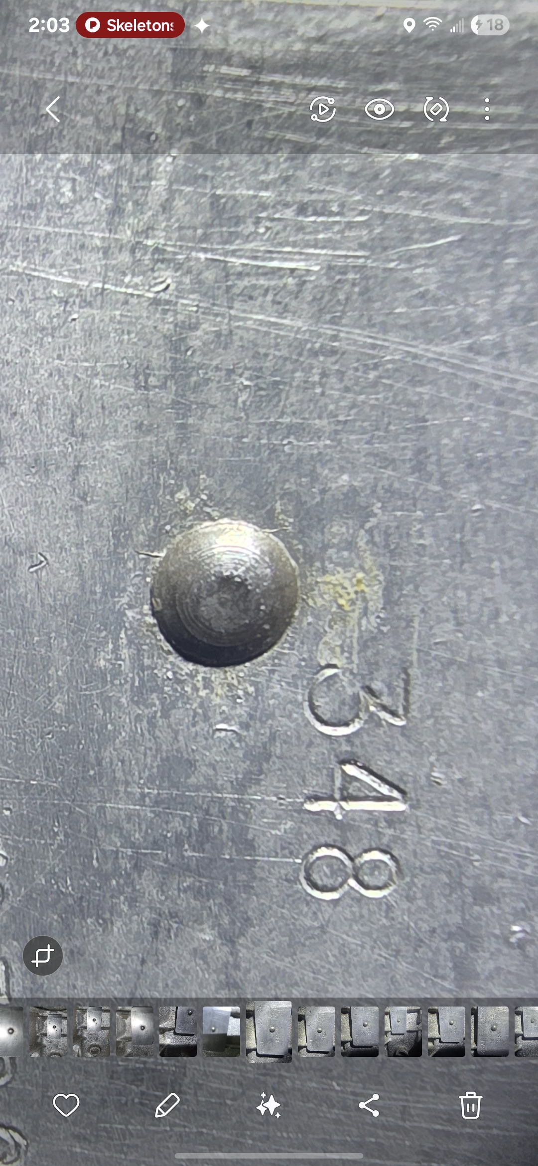

You guys are my last hope and maybe should have been my first. I recently looked at a '69 Chevrolet I was documenting with a turbo 400. It is definately dated 1969 (mid year) and has a yellow aluminum tag with "CY" on the side. (69-Y-xxx) I cannot find a "Y" code anywhere, only B, F, H and X for '69 turbo 400. It is NOT a '70 trans based on the tag date and is definately a Chevrolet trans. Someone please tell me what trans this is. HELP!!!

Attachments - The Supercar Registry TH 400 Alt Vin Location.jpg Screenshot_20250502_020331_Gallery.jpg IMG_6325.jpg cache.jpg

The 1969 hi po TH400 is CX code. Post the numbers on your trans tag on pass side and look for a vin no. on the vin pad on driver side just above oil pan.
