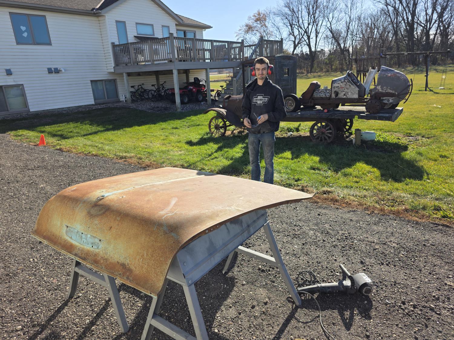

Cale stripped the extra hood and I welded up the hood bird and emblem holes.

Grandpa came over last night to help align the front end sheetmetal. This was a struggle that fought us every step, caused by one incorrect part.
The core support that we got with the car is for a '56
It's about an inch wider than a '55 core support. It bolted up to the 55 fenders, but we spent a few hours fighting the fender fitment before I sent Cale out to measure the core support of my '55.
Once we figured that problem out, we removed the core support and aligned things the best we could without it. Since everything moves so much without that support, the final panel gapping will have to wait for another time.
Also, the 2nd hood was a struggle as well. I think we'll be better off going back to bare metal on the first hood and spending more time hammering and shrinking.
