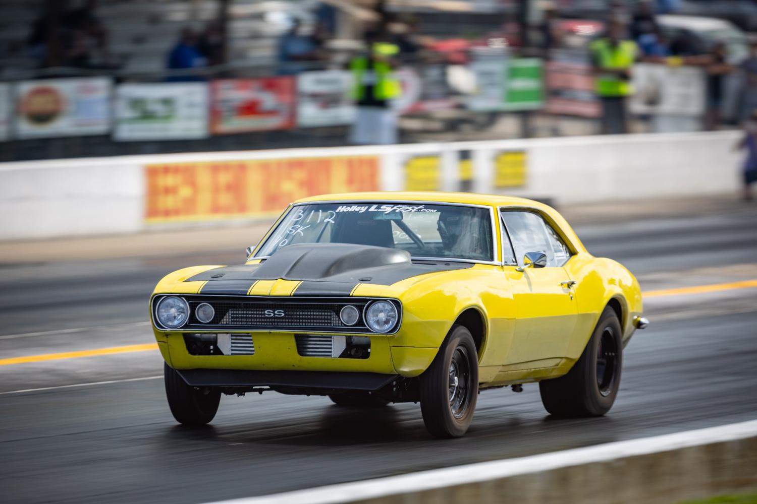

I took off the fender braces and used those holes for my hood pins. It puts them closer to the center and I believe it spreads the load more evenly. It's been like this for 30 years and several 125 MPH passes with no problems.

I agree totally with Freddie about placing them more inboard to distribute the wind load that happens when driving the car. My pins are located outboard of the the hood and I’ve just recently had to do some fiberglass repair on the front cross brace of the hood. I caught the crack developing in the brace before it caused damage to the painted surface.My Harwood Stinger hood takes a beating driving at 60 MPH moving up n down. It’s very lightweight and only weighs approximately 20 lbs..
If one has the option to place new hood holes then go with Freddie’s method. But if it’s a trailer queen all this makes no difference just place them to whatever suits your fancy.
