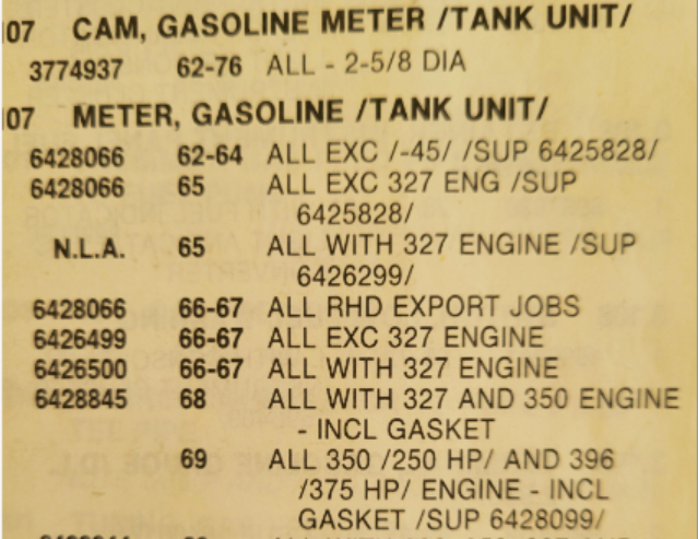

Originally Posted by Mr.Nickey Nova View Post
A L34 would have had a return line. I looked in a 69 Assembly Manual to make sure and it does show a return back to the tank. So, it looks like you have a L78 setup. Post some more pics of the car you have. Guys here love the pics...
Do you have access to the two different parts numbers for the sending units?
Im still looking for info regarding driveshaft stripe colors also. Thanks for replying.
