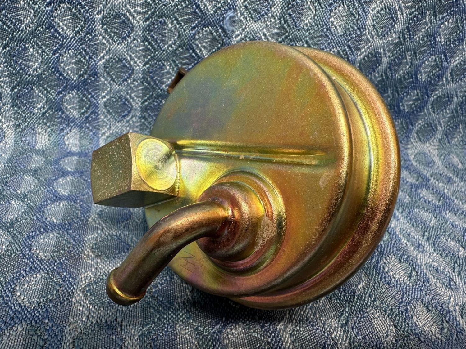

What would this number fuel pump be for 259Y40616 it's Nos
Attachments - The Supercar Registry s-l1600.jpg PXL_20250211_212506244.jpg 20250308_173704.jpg

259th day of 1985....Joe
G=1967
H=1968
I=1969
J=1970
K=1971
L=1972
M=1973
N=1974
O=1975
P=1976
Q=1977
R=1978
S=1979
T=1980
U=1981
V=1982
W=1983
X=1984
Y=1985
Z=1986

Guessing it is the same as a 40416, which would be Big Block Chevy.
Not sure why all the numbers in front of 40416. Maybe date code. 259th day of year "Y", whatever year "Y" represents?
I see Joe beat me to it.

Fuel pumps with a 2 letter code works like this.
The first letter is the month. A-L. "A" is January etc. Letter "I" is used.
The second letter is the year using the information I posted
......Joe

Joe, Can you write about when Julian Dating started versus only Month & Year
as I have a CI40726 that you said was March (C) of 1969 (I)
To All: I am looking for Correct Stamped Steel Fuel Section from
a Fuel Pump That looks like this................
I have a 40727 on my list with "FJ" which is June 1970. I think you had a pump with a Julian date that was July 1970. I could've happened at that poin but I would need to see more samples to confirm....Joe
