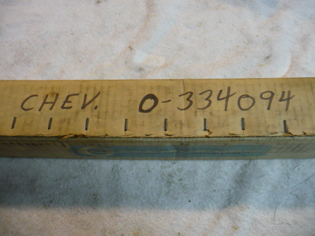

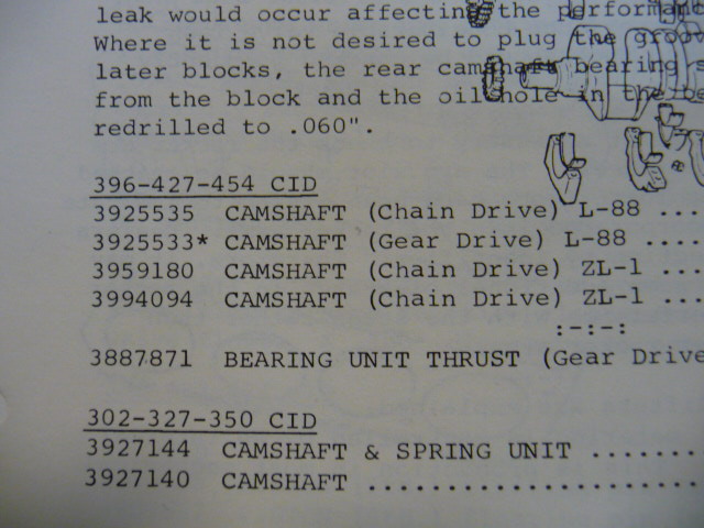

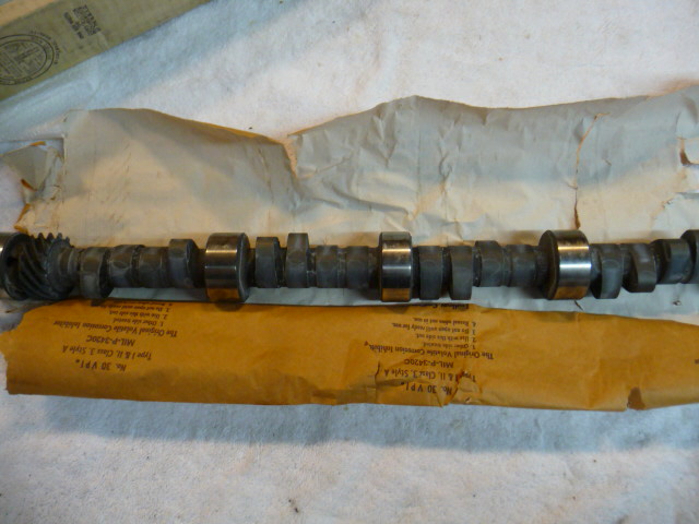

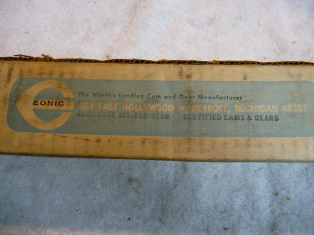

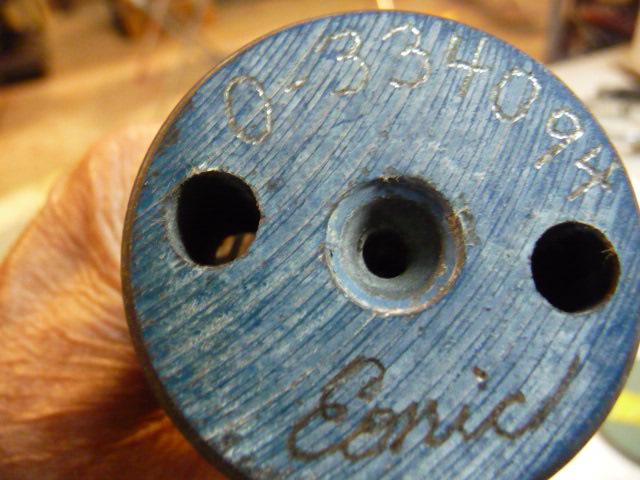

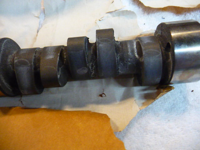

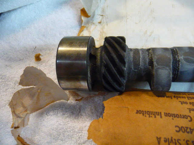

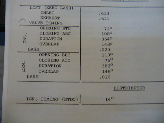

Hello, would this cam be similar specs to the solid cam that was installed in the LS7 454 crate engines?
