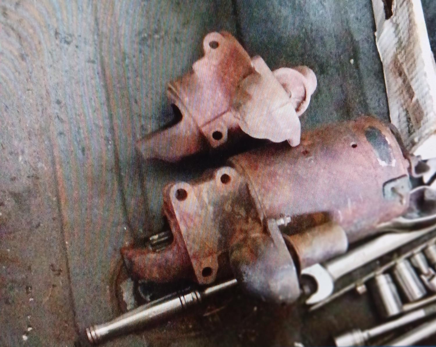

The one on top. Bolts are the right ones for it.
Originally Posted by JRSully View Post
Would also like to find out exactly what that correct nose is for a 418 starter, specifically a 70 L78 4spd application. TY
  #18
Old 07-02-2024, 12:09 PM
JRSully JRSully is offline
Location: Long Island
Posts: 2,505
confirming the "2 hole" nose is the correct 70 4spd 418, not the other "3 hole" one shown.? TY
