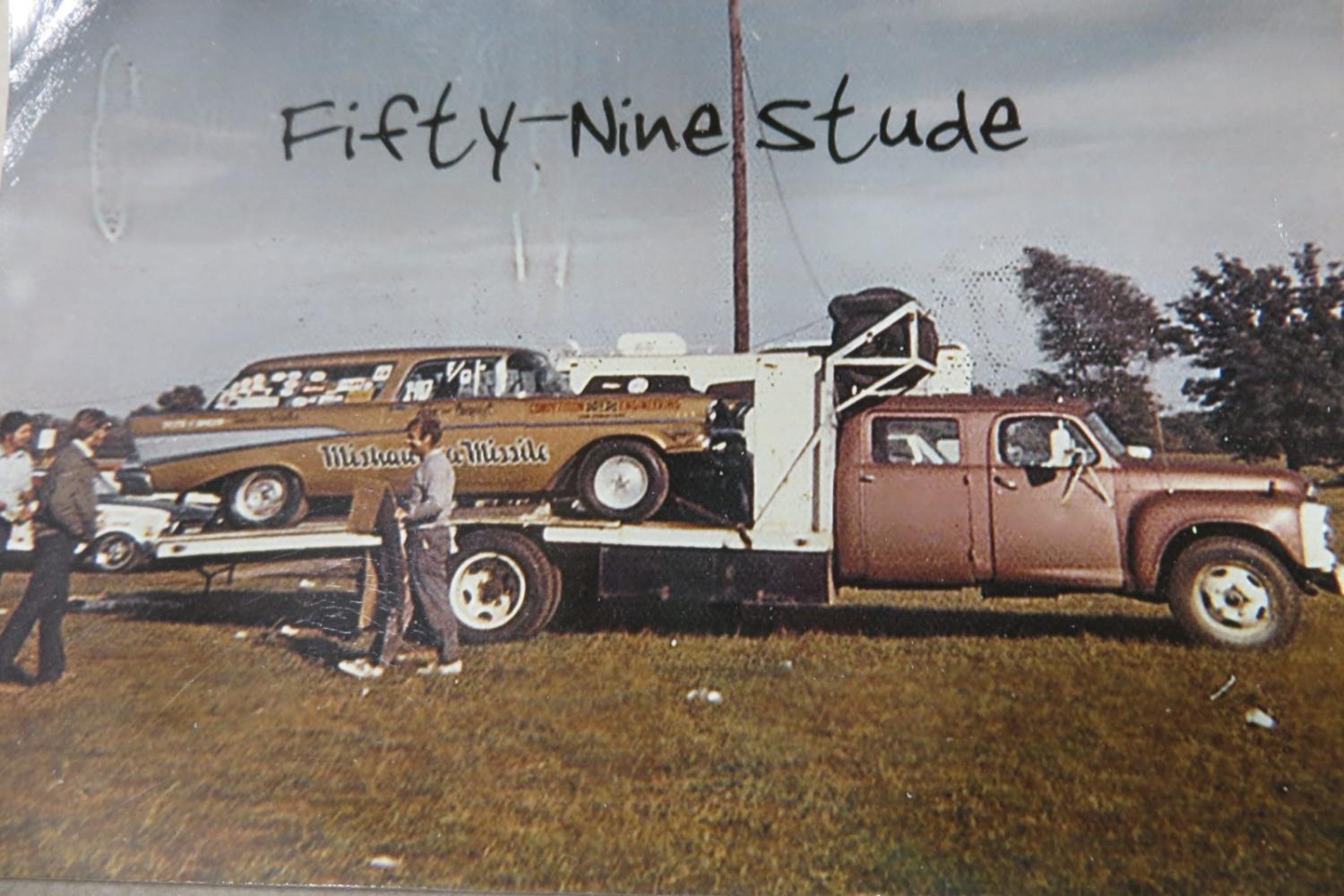

Friend had a Studebaker crew cab back in the late 60's/early 70's with a big block Chevy in it, a four speed truck trans, and a split rear end. He could and did get into impromptu races with well known factory drag teams coming home from US131 dragstrip in Martin, Michigian. His comment, "Let'e see if they can run over a hundred miles per hour with their rig."
