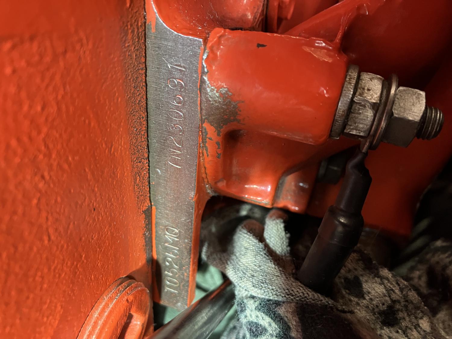

Jeff, I just now removed the paint from my block to get a more clear picture of my stamps. The 3 in my vin stamp is a round top 3. As you can see the block is the last week of May stamp. Cars TT is 06A.
Richard
