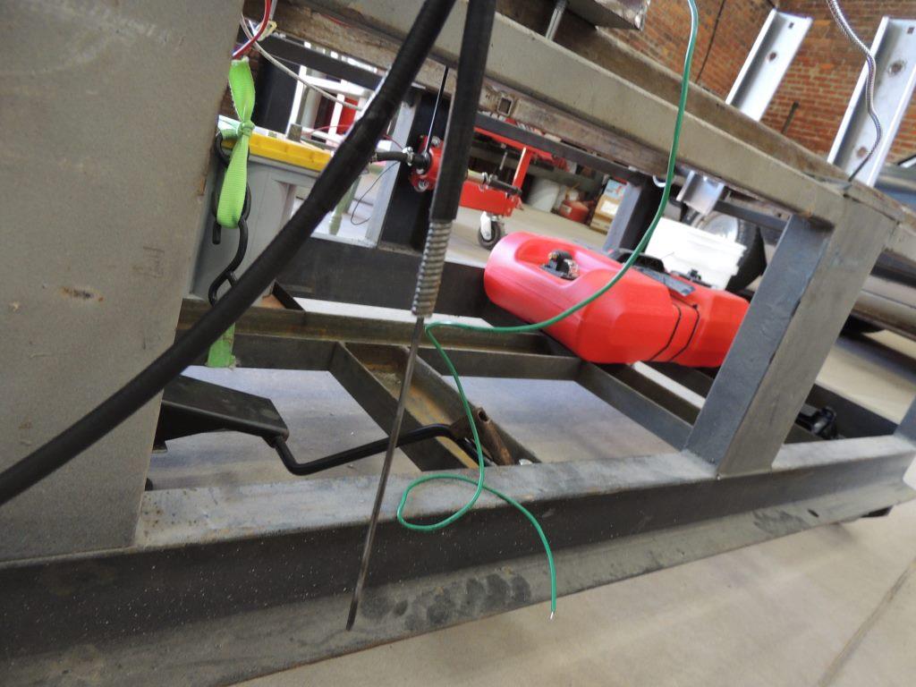

Decided to build my own. I have a good start. This is an extra body cart I got with a lot of parts I bought last year.
Really heavy "C" channel construction. The six pads on top are all 3/8 steel.
Figured I would build some dedicated stands for a Chevy. Then, when I get to the Studebaker supercharged engine, build some dedicated stands for that motor. Then, when I am ready to run the Ferrari V12.... well, you get the idea.
Anyone have some decent "plans" for an engine run test stand. I will adapt whatever is out there to this cart. It is 52 inches long and 26 inches wide.

Plan to put some larger casters on it with locking feature.

Made some progress on this today, before the heat got to me.
Still cannot find a radiator that has two outlets on each side. Figured this would be easy.
Only one I found on line is in Europe. https://races-shop.com/universal/404...2-outputs.html
Tempted to just purchase one for a 69 Camaro BB with four rows and a fan built in.
Found this one on Amazon. https://www.amazon.com/HonorPower-Ra...1zcF9hdGY&th=1
I know; it is made in China; but it is the same brand as the big four row I put in my El Camino, and I was impressed with the quality. It also solved my problem of running hot when towing in hot weather.
I want a big a$$ radiator, as the last thing I need is for one to start puking while I am breaking it in.
Because I won't need to bolt up a fan on any of the engines I will be testing, I can just snake radiator hoses around to get it hooked up. Stupid idea?
