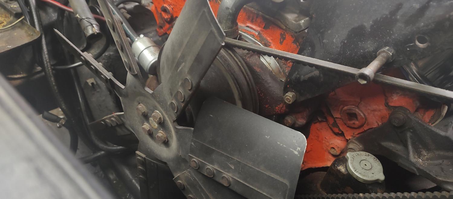

Tags are long gone.
Also, is this the right fan for a big block car? It's 7 blades but to my uninformed eye they look awful short. Maybe smaller= faster, I don't know.

That fan blade is not a Chevy item as far as I know. The 68 BB had a short water pump and depending on HP rating or options like A/C you could have a fixed 4 blade or a clutch fan with 5 blades. The 4 blade fan would require a spacer to position it properly inside the shroud.
This info is well presented on the CRG page I sent you. Of course, you can adapt to fit your needs...more horsepower usually increases the need for proper cooling system components.
