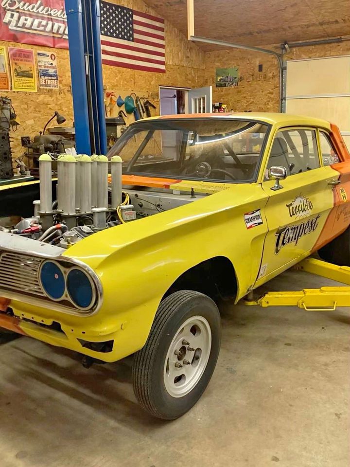

I'm curious what sort of modifications are made to a '63 Lemans or Tempest for drag racing. Specifically the rear suspension and the transmission tunnel.
I've always liked these cars and think about getting one from time to time.
If this green one had been closer to me I would have followed up on it. If anyone is curious about this particular car I have more pics of it from the online ads, it went to California is my understanding.

Tom Schlauch is our resident expert on these, but I think you nailed it in your comments.
Most use a big Pontiac or Olds rear axle and hang it with either ladder bars or a four link. Add a transmission tunnel from a donor car to clear the engine mounted trans and traditional drive shaft.

Looks like that one has the big Olds Pontiac rear end in it with some kind of ladder bars.

I have done 3 of them.If doing a new now I would use a ford 9 inch with coil overs and ladder bars.They are a unibody car so if using a pan hard bar if mounted to the unibody rail it will have to be reinforced.I’m told the hot ticket is a First gen bird floor.The firewall will have to be cut almost half way up to clear a bellhousing.Tom

Hmm so based on your comments guys and the posts I've seen on PerformanceYears in the past, it's a lot of custom fabrication.
I've kept my eye on a built roller, maybe that's something I should focus on.
