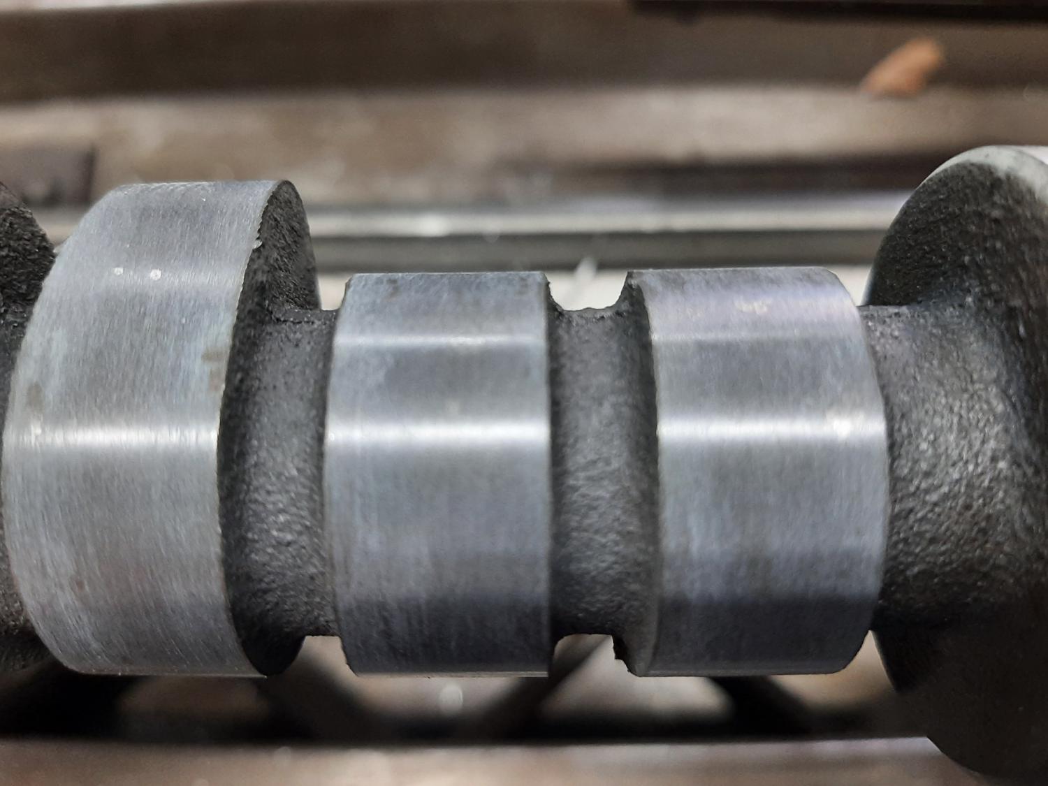

I been reading a lot about new solid camshaft and lifter failure on start up. I have a new Comp cam in my 69 Z28. Hasn't been fired yet. A engine builder I know said he won't build a motor with a solid cam because of all the failures. Any input is appreciated.
