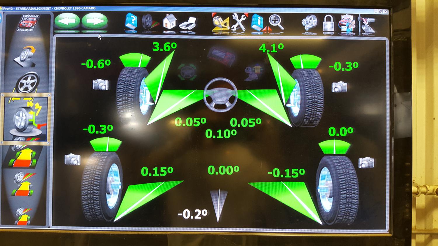

These were my results with stock A arms on a 69 Camaro. I could not get them any better. Chart shows 1996 Camaro because it did not have 69 spec data pre-installed. I was trying to get as much positive Caster as possible. I run BF Goodrich TA's.
Caster:
3.6 deg drivers side
4.1 deg passenger side
Camber:
-0.6 deg drivers side
-0.3 deg passenger side
Total Toe:
0.10 deg
