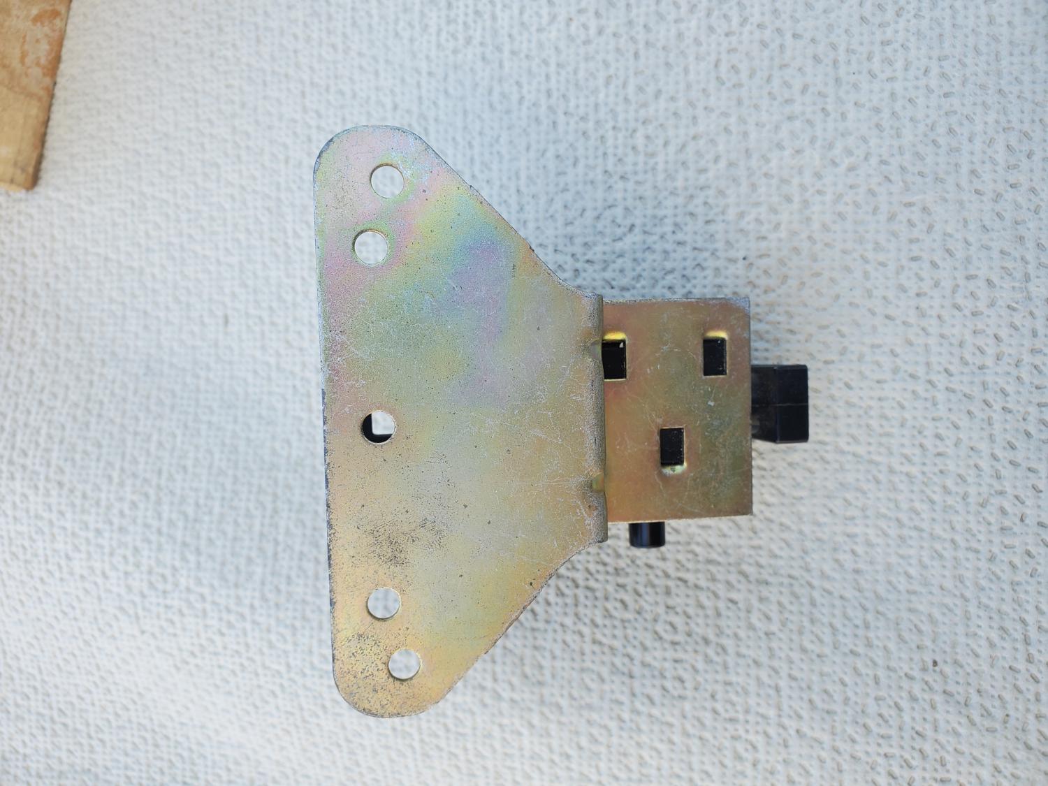

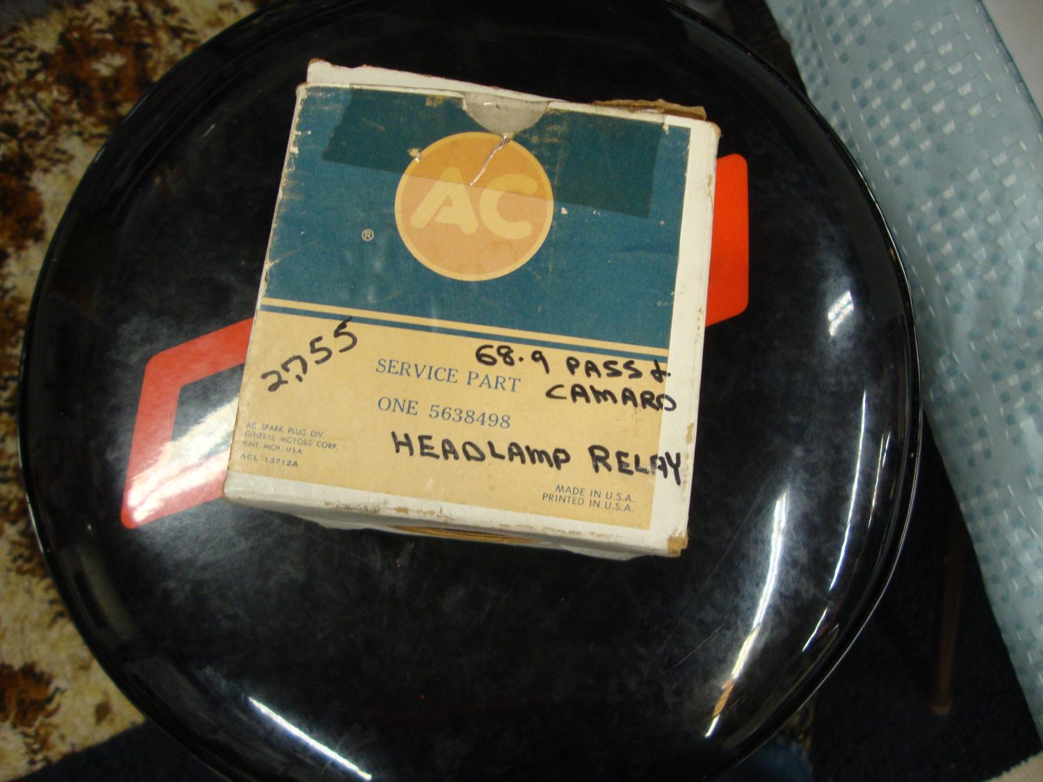

Need an NOS Rally Sport Vacuum Relay PN 5638498 for my 69 Camaro RS/Z restoration project. Please PM if you have one available, thanks.
(internet photo)

The relay fails when the internal rubber piston deteriorates into dust.
The last RS system I worked on a few years ago had an NOS relay installed in the '80s. After hours of chasing the problem to no avail, the relay was replaced on spec with the identical licensed repro. Problem solved.
Cut open the still-new appearing relay, full of rubber crumbs.
