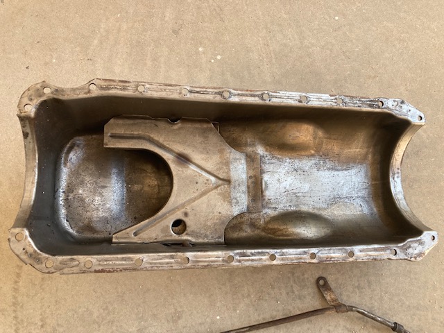

Here are some photos of a 66 pan and dipstick. Larry

lbnaz, I believe the pan you pictured is not a 66 pan. 66 oil pans had a hole in the front to allow it to be bolted to the bottom of the timing cover. 67 had the hole also but different baffling.

The pan pictured above appears to be a '69 pan and would be a good one to look for. I don't need an early pan with the extra bolt hole, and I like the location of the drain plug in the later pans too.
NOW, did that pan continue on from '69 ? and for how long ?

Two '69 and later pans. I'm pretty sure the one on the left came from a '69 L78 and the other is NOS, from the 1980s.
