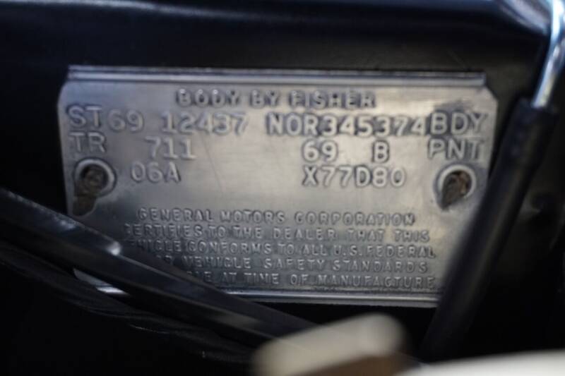

Wish the seller would have provided pictures of the docs and engine/trans stamps. Looks like a good car that still seems to retain its original seat covers and door panels.
Link to 1969 Z/28 auction
124379N653589
Attachments - The Supercar Registry Ra78885598768c9b12758d1ebea70824e.jpeg My Pace Car Broadcast 640491.jpg Firebird VIN.jpeg 124379N653589 Tag.jpg

Broadcast sheet on a Norwood car gives me pause.

http://www.camaros.org/forum/index.php?topic=19225.0

So the link to CRG says the docs are repro.
Old 04-20-2021, 01:44 AM
Location: Woodland, ca. US
Posts: 16,053
Thanks: 539
I sent the seller a message with the link to CRG.
