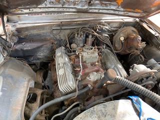

My 19 year old son rescued his first project car last week a 67 camaro rs. Car has been sitting for at least 25yrs so of course all the brake fluid in the master is gone with that little bit of gook sitting on the bottom. Planning on changing master, wheel cylinders(2 are frozen) spring hardware and linings. Would you guys recommend changing the hoses(not cracked) and proportiong valve. Is the prop valve something you can take of and try to clean? Its a power 4 wheel drum car. Thanks, Mark

Old 11-02-2020, 01:31 AM
wannarun70 wannarun70 is offline
Join Date: Sep 2006
Location: long island ny
Posts: 297
Thanks: 42
Thanked 21 Times in 14 Posts
Not exactly a gem yet, but heres a couple. 327 rs, Ermine white/red interior.
