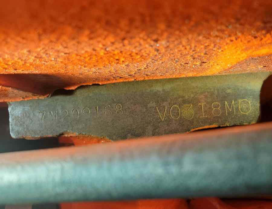

Subject VIN 124377N210105
No Dealer info or real details of incorrect engine etc also lots noted as 'correct' so listing could've been better if all genuine?

Were 67 Z28's available with a 3.31 rear axle?

Don’t know Bill, but I don’t think any of the drivetrain is original in that car. Looks clean enough...would make a fun driver at the right price.

I heard back from the seller’s agent, and they do not have the POP, nor any other documentation. No idea of the selling dealer either. Without any original drivetrain components, I guess their claim of it being a Z28 hinges on the trim tag...
Seller is looking for $68.8k firm.

It was owned by a different guy in Canada who restored it circa 2007. He said it came out of Georgia. There was no original drivetrain in it and no P-O-P at that time.

hate to say not possible, but I have never seen a 3.31 in a first gen Z.
3.73 standard, 4.10 performance, and I THOUGHT 3.55 economy (there's a euphamism).
Several 4.56 around. Never seen a 3.31.
There is a chart somewhere showing what was available, but I can't find it right now.
To add to the confusion, there is very little dealer order info, as the Z/28 was a bit late to the dance in 67.
Can't imagine it being too fun to drive with a 3.31 rear.
