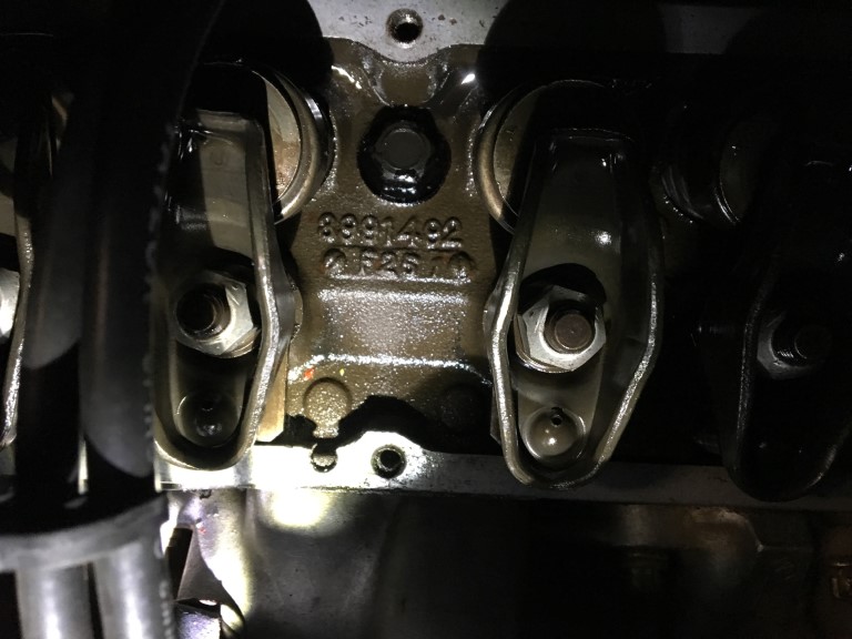

That's really nice, but is it a '72 LT1 or is it a '70 LT1 that was sold in '72? There's a big difference in the heads and compression ration.

Looks like a Camaro engine that was run and removed. Also the seller should have put the head P/N and head and block casting date for general information.

Also "double hump" (probably '492 castings) 64cc chamber heads, so that is good for a 70 LT-1.
Also looks to be the OTC '2116 intake.
I thought at first the intake had been painted silver, but I think the silver paint on the head is from the lift hook.
Not seeing where this has been installed and run.
