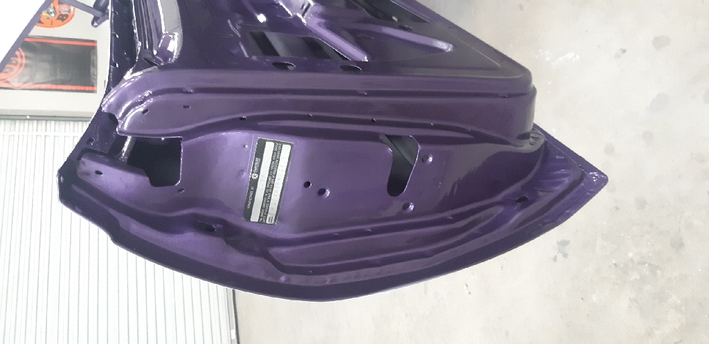

So today the door jambs get painted and here's the details on the fender tag. You can see the slight bend in the tag on the left side with the painted screw.

Gotta love those details! Even the original, assembly line, dome-headed screws, too. One painted, one natural finish.

Yep, Steve-O! See that little notch on the fender tag? Original! Jambs are waiting on clear as we speak! Going to start ripping apart the suspension later today as we discussed and start blasting the parts.
More soon....

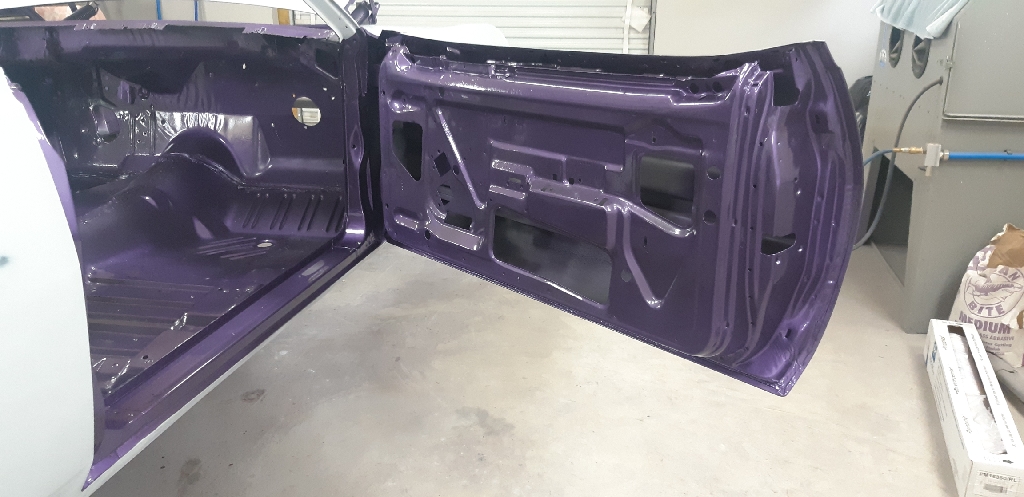

Jambs are painted! While that was curing and with nothing else to do, I jumped over and disassembled the suspension in preps for blasting, replacing, and detailing.
Also found this green marking on the idle arm mount when I pulled it off. I've seen this green mark before on Hamtramck cars and St. Louis cars but it's usually on the engine mount point on the a-frame.
It'll go back like original! Gotta lift the engine then pull the k-frame out to start the cleaning and repaint.
More to come...
