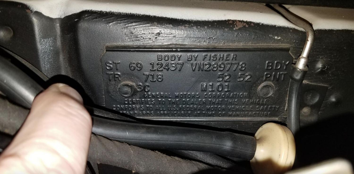

Amazing condition for a car that was restored nearly 40 years ago. Love the VE3 and console 8-track. Unfortunately, no mention in the auction as to what's original and what isn't, but overall, one of the most desirable color combos for a '69 Z IMO.
Link to 1969 Camaro RS/Z auction
124379L520000
Attachments - The Supercar Registry Screen Shot 2020-06-23 at 10.50.22 AM.jpg Image from iOS (4).jpg 124379L527283 FAKE TAG.jpg

Trim Tag
I ain't nobody, dork.

Fender stripes are incorrect, right?

I have seen the real early built z28 with style trim with the fender pin strips

Odds are very few Z/28s built with D96. As of 9/12/68 they were no longer included on style trim Z/28s but remained optional. As of January '69, no longer optional.
Car in question was built on or about January 31 and would not have had them.

Originally would have been red, black stripes, red interior.

----Apparently restored to the owners taste, and I have to say it's really good looking. Whoever ends up with this Z should dump that master cylinder though...….Bill S

NOT an original numbers-match driveline car.
