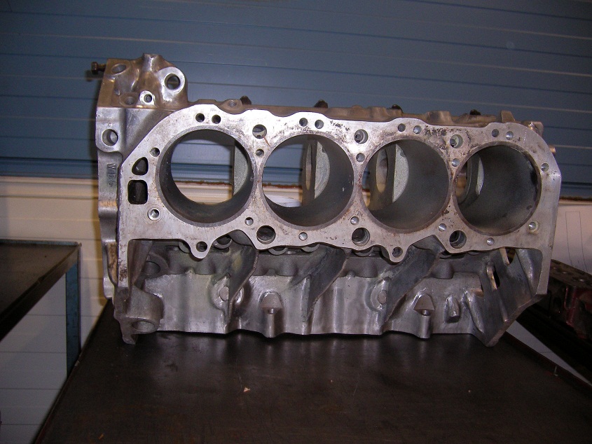

Even to this day, the 430 BB Chevy is not very well known. I see different info on these engines but from what I can tell, Chevy made the CanAm 430 from about 1968 to 1972.
The aluminum CanAm cast iron sleeve block used a large 4.440 in. bore siamese cyls design.
In 1968 it used a short stroke 3.47 in. crank to get 430 cu. in. and about 700hp on gas.
There was some info printed that the 430 Chevy was considered as a production engine for 1970 but was cancelled along with other 1970 engine options.
In 1969, it was available as a 430 cu in and also with 427 or 454 cranks to get a 465 or 495 cu in and over 750hp.
Chevy also built a Can Am block without the cast iron sleeves and they can go over 500 cu in.
Chevy engineering used the Can Am engine for research using the same siamese cyls design on the 400 cu in small block production engine.
The Alu engine block with no cast iron sleeves design was used in the Vega engine. They used a special cast iron coated piston to control wear.
The CanAm BB Chevy engine dominated CamAm racing late 60's to early 70's beating Ferrari, Porsche, and Ford, all who had more expensive exotic engines.
The 430 CamAm engine would rev like a 302 and was about the same weight installed.

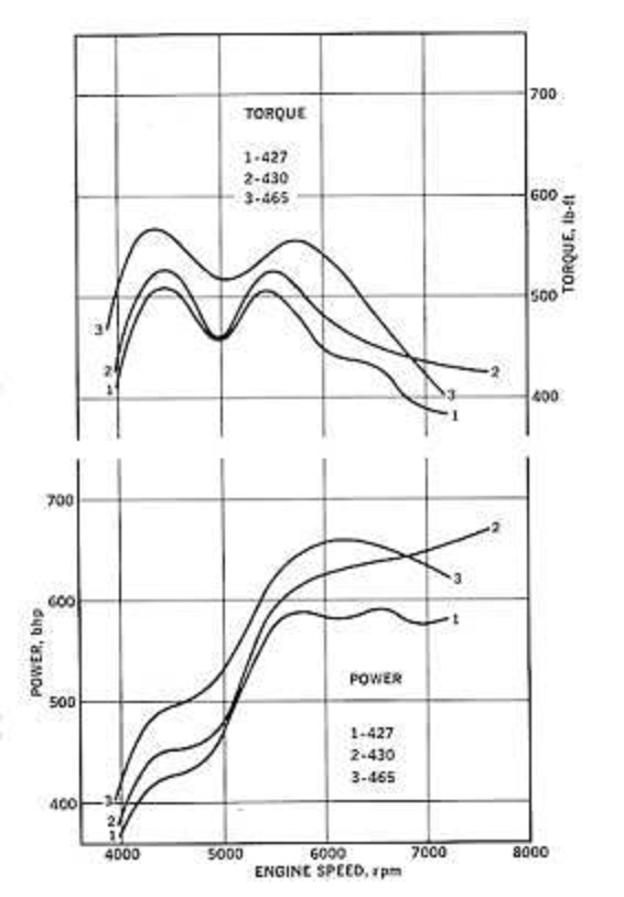

From reading about the 430 Chevy , there were a few comments that it " would rev like a small block" or "rev like a 302".
I think they were taking about the short stroke or de-stroked dimensions , large bore to short stroke dimensions.
To get the SCCA legal 302 cubic inches, Chevrolet used 327 block and 283 crank so a 4.00" bore and a 3.00" stroke which was considered a short stoke for the 4 in bore size
similar to the 430 Chevy, that had a large 4.440 in. bore and 3.47 in. stroke vs the 427 L88 Bore and Stroke 4.251 in. x 3.760 in

I'm not an expert on the 1970 NHRA rules but read that 1970 Pro Stock was run on 7 HP per pound so the 430 Chevy could run in a 3010 lb Camaro.
by 1971 they were going into the mid 9s in NHRA Pro Stock so were making pretty good power on gas with tunnel ram 2x4bbs
the online ET-MPH-HP calculator says " Your HP is 693.88 computed from your vehicle weight of 3010 pounds and ET of 9.50 seconds"
The 430 CamAm engines were making good power also here is a youtube vid
Dyno Testing - 1973 McLaren Can-Am Big Block Chevy
where it pulls 750hp
They don't say if its a 430, 465, or 495 cu in engine
https://www.youtube.com/watch?time_c...ature=emb_logo
