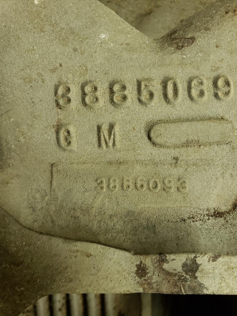

I haven't ever seen one like this. I have had this for over 20 years and just dug it out but never noticed it when I got it. anyone know why it was done like this?

Early L88 unit?

any idea why they used two part #'s

No, sorry. Development process maybe?

One number could be the raw casting number and the other is the finished/machined part number.

What Keith said.
