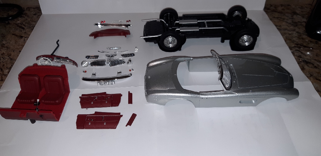

Super Energizer Bunny Captain Dave, can we gits a pigture of the model B4 you strip in ?

Oh yeah, Mike. I'll start another thread for the model teardown! Just kidding. But I will be showing the whole process start to finish, so don't you worry! I'll show the model prep and hopefully I'll be there for the scan or at least get photos.

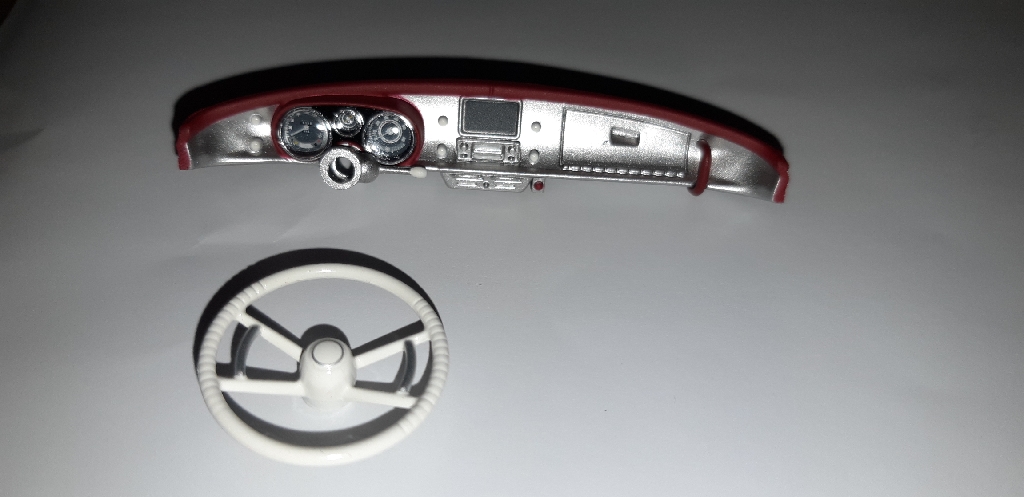

This has to be the fastest I've ever disassembled a car!
I'm overly impressed with this model as far as accuracy and details. So now that its torn down, time to get it primed. The best part is the 3D scanning guy can make a CAD file for the dash along with the ever important windshield frame to ensure correct dimensions.
