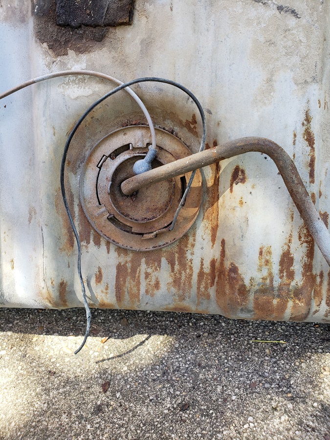

Fuel tank was out of the car but included, it is a single line pick up, no return.

There are no big blocks with a single 5/16 fuel line. Are you sure its 5/16??

big dummy here...typo it is 3/8 fuel line.

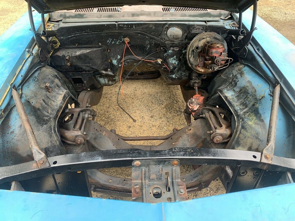

photo of fire wall, speedo cable on drivers side

I'll guess L-78 4-speed

Lightened up your picture a bit

Chris...can you measure the length of the speedo cable?
