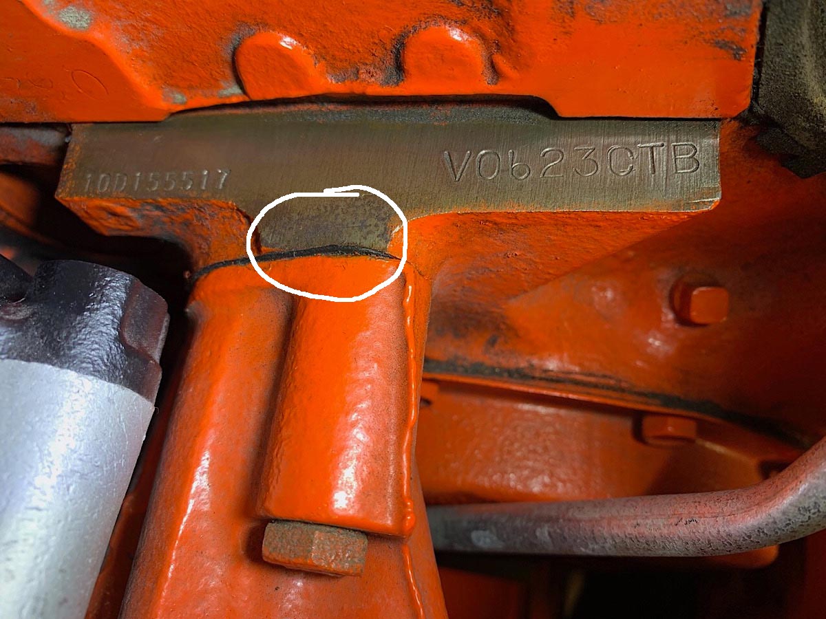

Eddie M is looking for some feedback on this stamp. Thanks!

Thanks for the resizing sammmmmmmy!
yes looking for some thoughts on this stamp please

Is that a D in the partial vin?

Bad in my opinion.
The partial VIN doesn't make any sense to me. What is "D" for an assembly plant? Van Nuys was L and Norwood was N. The sequence number is way out also. seems weird the broach marks end as it goes under the head, doesn't it?

Yes looks like a D
Im not a 70's expert on this stuff - so appreciate the feedback.....
agree with the broach mark comment - seems weird to me too

Eddie, I’m no expert on stamps, but Camaros were only built in Norwood which would be an N in the vin, or Van Nuys which would be an L. Sequentially, I’m pretty sure they started at 500000. Therefore, I don’t like it!

Is it a whole car? Or just the engine?

whole car - but i don't have the VIN currently - that would tell about the vin stamp for sure

http://www.1970z28camaro.com/misc/#
My old 1100 mile Z for comparison

Did they go back to the vin on the pad in 70 or just on Los Angeles cars?
