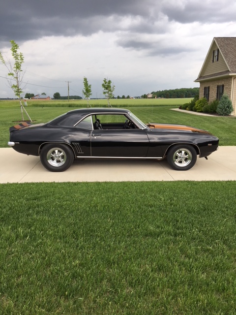

I have a brand new set of 5.60-15 Pro-Tracs never mounted. They measure 25.5" tall with no wheel in them.

Here's the look on my 1969 Camaro. These are a borrowed set....I liked the look so bought a pair. FWIW my front springs are not stock.
