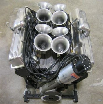

Here's the engine from my Scarab race car with the Summers Brothers set up. I'm certain it is fixed in this position. There is a big spacer for the water pump and the pump is electric. I've had no issues with this set up.

Here's a good shot of the spacer and water pump.
