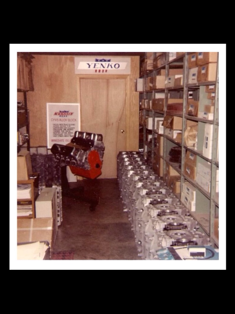

New here. Short version. I bought a 68 Camaro, it came with a bunch of parts, one item is an engine block in a crate, that I am told was bought over the parts counter (parts guy name Smitty) in the 70's at Yenko Chevrolet, and it is an ZL1 . I have opened the crate, and found the Winters Foundry logo on the block and a magnet does not stick. At that time I still had a half of a UHaul truck full of parts to unload and my help was leaving, so I boxed the engine back up without even looking for a casting number. My plan is to reopen the crate this weekend and further inspect this engine. With that said; What am I looking for to identify this engine? Newspaper in crate dated 12/21/76 Shipping label is from Yenko Chevrolet. Sorry for picture quality, when uploading kept telling me file was too big, so i guess when I cropped it quality changed.

Definitely is ZL1 with the cast # and seeing extra head bolt boss on block. Winters snowflake may not be winters though. Check and see if it has a W in the center of snowflake. Most Yenko blocks had SYC stamped small in timing cover area or a large Yenko crest in front of block. Also some Yenko blocks I believe had other part number 053.
Looks like a nice haul...congrats!! Some were tall blocks also.

Thanks for the information. There is a W in the middle of the Snowflake. I searched the block well I did not see Yenko anywhere. The only writing was the torque numbers. Assuming that Yenko had their "own" version or block ?
