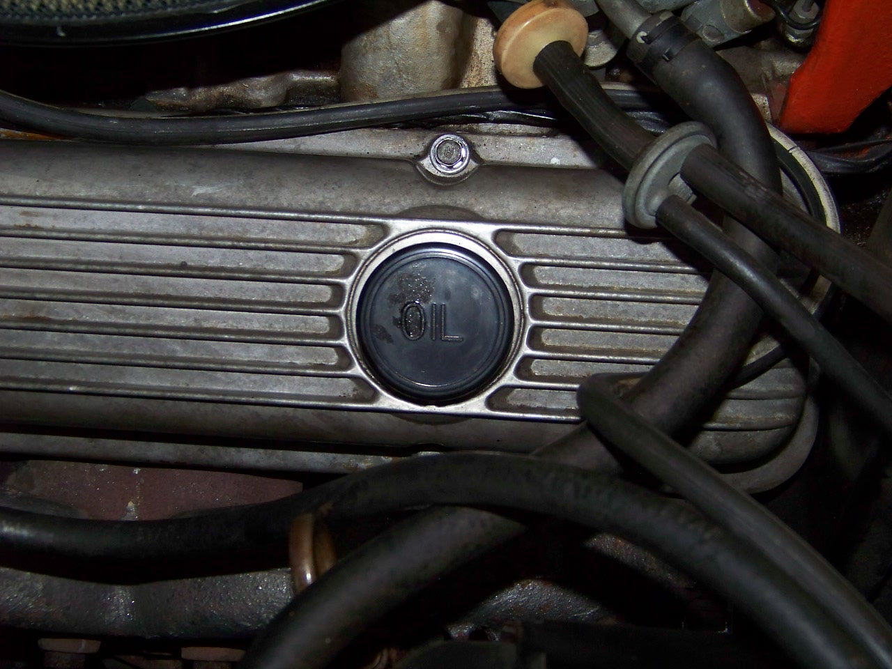

hi
need help please with the correct way to restore my deuce LT1 valve covers
fro cleaning / striping/ and what finish to put on them?
thank you
chris
1970 citrus Yenko Nova
Attachments - The Supercar Registry valvecover_before.jpg valvecoverPrior2.jpg valvecoverfinish.jpg Valve Covers.jpg
